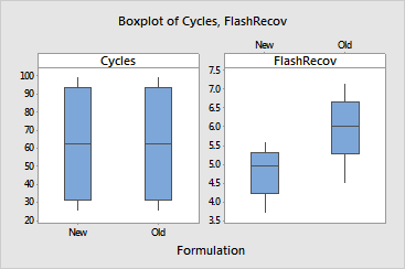

Suppose you have conducted tests on the new and old formulations of a battery. You decide to create boxplots for two variables and, because you will use the same graph dialog box to create them, you panel the graphs to simplify comparison.
  Open the worksheet BATTERIES.MTW.
2    Choose Graph > Boxplot.
3    Choose One Y With Groups and click OK.
4    Under Graph variables, enter Cycles FlashRecov.
5    Under Categorical variables for grouping, enter Formulation.
6    Click Multiple Graphs.
7    Under Show Graph Variables, choose In separate panels on the same graph.
8    Click OK in each dialog box.
Graph window output
