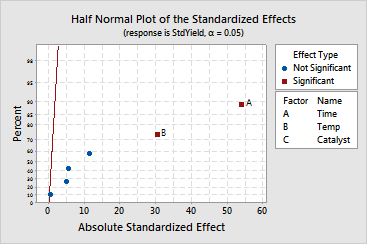

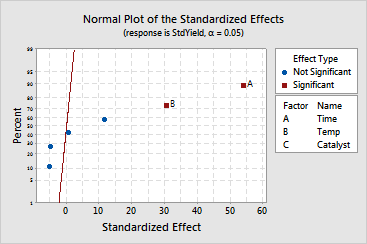

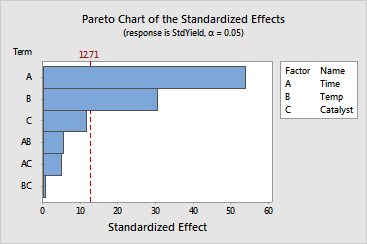

6    Click Graphs. Under Effects Plots, check Pareto, Normal, and Half Normal. Click OK in each dialog box.

The normal, half normal, and Pareto plots of the effects allow you to visually identify the important effects and compare the relative magnitude of the various effects. The plots confirm that time and temperature are significant at the 0.05 a-level.

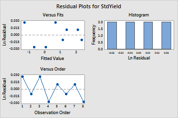

9    Under Residual Plots, click Three in one.

The residuals plots show no evidence of patterns or outliers.
