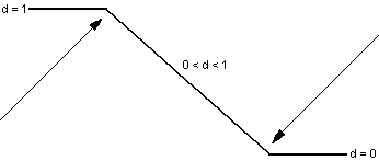

Suppose you have a response that you want to minimize. You need to determine a target value and an allowable maximum response value. The desirability for this response below the target value is one; above the maximum acceptable value the desirability is zero. The closer the response to the target, the closer the desirability is to one. The illustration below shows the default desirability function (also called utility transfer function) used to determine the individual desirability (d) for a "smaller is better" goal:
d = desirability
Target
any response value less than the target value has a desirability of one
Upper bound
any response value greater than the upper bound has a desirability
of zero
As the response decreases, the desirability increases.
The shape of the desirability function between the upper bound and the target is determined by the choice of weight. The illustration above shows a function with a weight of one. To see how changing a weight affects the shape of the desirability function, see Setting the weight for the desirability function.
