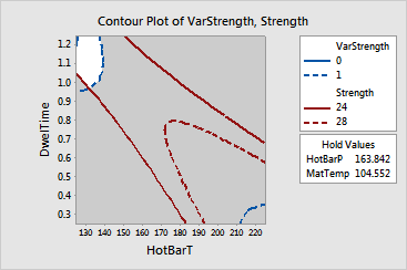

8    Click Settings. In Setting, enter 163.842 for HotBarP and 104.552 for MatTemp.
9    Click OK in each dialog box.
Graph Window Output
Interpreting the results
The white area in the upper left corner of the plot shows the range of HotBarT and DwellTime where the criteria for both response variables are satisfied. You may increase or decrease the holding value to see the range change. To understand the feasible region formed by the three factors, you should repeat the process to obtain plots for all pairs of factors.
You can use the plots in combination with the response optimizer to find the best operating conditions to seal the bags.
This plot uses model equations. Ensure that your models are adequate before you interpret the plot.
