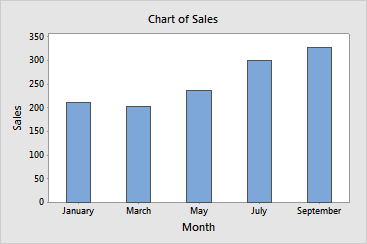

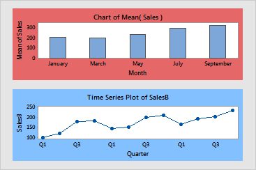

The figure region is where Minitab displays a single graph. The figure region contains items specific to a graph: data, legend, scale elements, titles, and footnotes. A figure region uses a coordinate system in placing items relative to the figure. See Region Coordinate Systems. The figure region usually fills the entire graph region; to place more than one figure region on a page, use a layout.
A single figure region is transparent and takes up the entire beige-colored page  region.
Two figure regions share the same graph region. The normally transparent figure regions are colored red and blue here.
