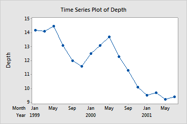

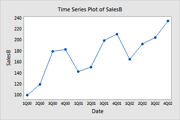

Example of x-axis with a stamp column
Example of x-axis with two calendar units - month and year
