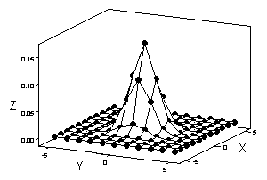

Contour plots, 3D surface plots, and 3D wireframe plots are always constructed on a grid of evenly spaced x- and y-values called a mesh.
·    If your x- and y-values are evenly spaced, Minitab uses the regular mesh defined by your data and plots the z-values at the mesh intersections.
·    If your x- and y-values are not evenly spaced, Minitab interpolates (estimates) the z-values at the intersections of a regular 15 by 15 mesh with the same x- and y-ranges as your data. You can choose the interpolation method Minitab uses to determine the z-values for the mesh intersections.
Mesh created from regular data – the x- and y-values form a regular grid.
Mesh interpolated based on irregular data - x- and y-values do not form a regular grid; therefore, data points are not always at the intersections of the mesh.
