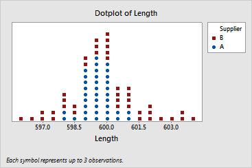

You work in an auto factory and are having trouble with variability in the length of the camshafts you use. You want to see if the shafts provided by your two suppliers are comparable, so you measure length for a random sample of 100 shafts from each. Create a dotplot with stacked groups to compare the samples from the two suppliers.

Graph window output
Interpreting the results
The mean lengths of the camshafts from the two suppliers appear to be similar. However, there is a great deal more variability in the length of shafts provided by supplier B. You might investigate supplier B's process more carefully.
