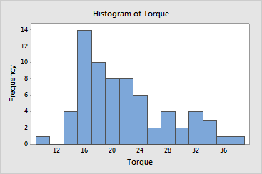

Graph window output
Interpreting the results
Most caps were fastened with a torque of 13 to 25. Only one cap was very loose, with a torque of less than 11. However, the distribution is positively skewed; several caps were much tighter than they should have been. Many caps required a torque of greater than 24 to remove and five caps required a torque of greater than 33, nearly two times the target value.
