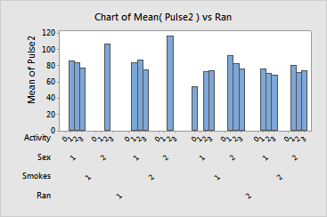

·    You can choose to include/not include empty cells on your graph. Empty cells are groups that only have missing values. These empty cell groups may occur with highly nested designs and may make the graph look cluttered.
For example, in this graph, the following groups are empty cells:
·    Ran1-Smokes1-Sex1-Activity0
·    Ran1-Smokes1-Sex2-Activity0, 1, and 3
·    Ran1-Smokes2-Sex1-Activity0
·    Ran1-Smokes2-Sex2-Activity0, 1, and 3
·    Ran2-Smokes1-Sex1-Activity1
·    Ran2-Smokes1-Sex2-Activity0
·    Ran2-Smokes2-Sex1-Activity0
·    Ran2-Smokes2-Sex2-Activity0
If you choose to not include empty cells, these groups would not appear on the graph.
For more information, see Include empty cells- Group Options.

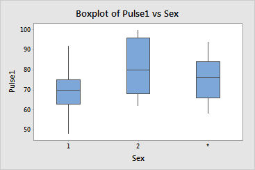

Missing Categorical Values
In almost all graphs, you can choose to include/not include missing categorical values as a separate group in your graph.
For example, this is a boxplot of student pulse rates grouped by sex, when Sex contains a few missing values.
For more information, see Include missing as a group - Group Options.
