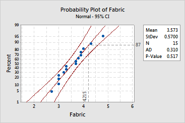

Graph window output
Interpreting the results
A normal distribution with a mean of 3.573 and a standard deviation of 0.57 appears to fit your sample data fairly well:
·    The plotted points form a reasonably straight line.
·    The plotted points follow the fitted distribution line fairly closely.
·    The p-value for the Anderson-Darling test is above 0.10.
Because the distribution fits your data, you can use the fitted line to estimate percentiles for the population. The estimated 87th percentile for burn length is 4.215.

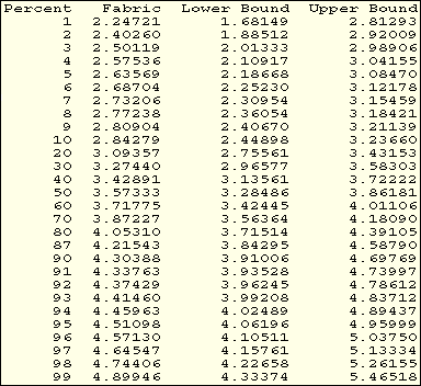

If you hover your mouse over the fitted line or confidence intervals, Minitab displays the fitted percentiles and associated confidence bounds for several points:
You can be 95% confident that the 87th percentile for the population is between 3.84295 and 4.58790.
