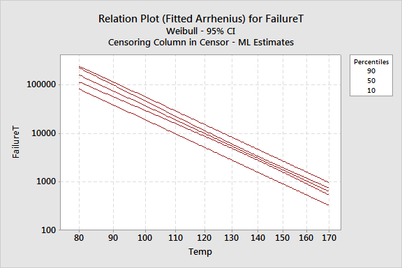

With the relation plot, you can look at the distribution of failure times for each temperature - in this case, the 10th, 50th, and 90th percentiles.

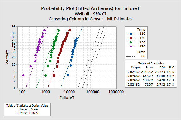

The probability plot based on the fitted model can help you determine whether the distribution, transformation, and assumption of equal shape (Weibull) at each level of the accelerating variable are appropriate. In this case, the points fit the lines adequately, thereby verifying that the assumptions of the model are appropriate for the accelerating variable levels.
