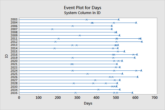

You want to estimate the replacement rate of a certain valve on a fleet of 24 diesel engines.
1    Open the worksheet VSEAT.MTW.
2    Choose Stat > Reliability/Survival > Repairable System Analysis > Parametric Growth Curve.
3    In Variable/Start variables, enter Days.
4    In System ID, enter ID.
5    Click OK.

Interpreting the results
The estimate of the shape (4.004) is greater than 1, indicating that the failure rate is increasing. You can be 95% confident that the interval (3.282, 4.884) contains the true shape.
The test for equal shape parameters indicates that there is not enough evidence to say that the systems come from populations with different shapes (P-Value = 0.425). The pooled estimate of the shape is valid.
The tests for trend are all significant (P-Value = 0.000). This means that there is enough evidence to reject the null hypothesis that there is no trend in your data. You can conclude that the increasing trend is significant.
The event plot seems to show a pattern of failures that become more frequent as time goes on.
