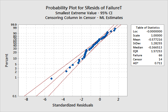

To see how well the model fits, you will draw a probability plot based on the standardized residuals.

7 Click Graphs. Check Probability plot for standardized residuals, then click OK in each dialog box.

Graph window output:

The probability plot for standardized residuals will help you determine whether the distribution, transformation, and equal shape (Weibull or exponential) or scale parameter (other distributions) assumption is appropriate. Here, the plot points fit the fitted line adequately; therefore you can assume the model is appropriate.
