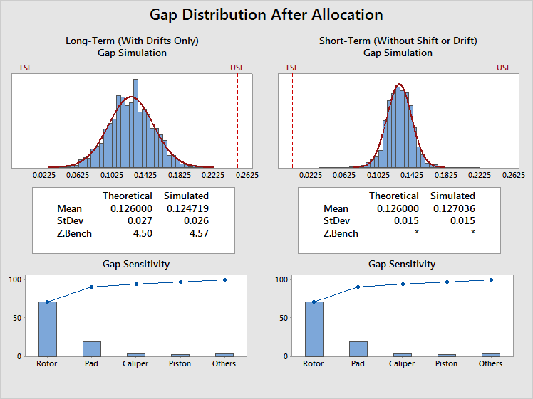

Gap Distribution After Allocation

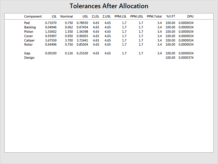

Tolerances After Allocation
Graph window output
Interpreting the results
As shown in the Session window output, the long-term gap Z.Bench now equals 4.5, which is the goal. More importantly, the design now has an overall yield of ~100%, compared to the original design's overall yield of 46.91%.
It should be noted that achieving a long-term gap Z.Bench of exactly 4.5 will not always occur with a variance pool, while it should always occur with a mean pool.
The table of adjusted means and standard deviations show what the short-term means and standard deviations must be for each element in the assembly, to achieve the desired long-term performance of the assembly. These values are then used to calculate the optimal tolerances for the elements in the assembly.
See Calculating the specification limits for more information on calculations.
