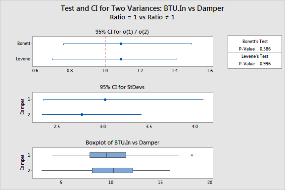

Graph window output
Interpreting the results
The method table displays the hypotheses being tested. Because you accepted the defaults, the null hypothesis states that the ratio of the two population standard deviations is 1 (they are equal) and the alternative is that the ratio is not equal to 1 (they are not equal). The test results are at the bottom of the output.
The statistics table displays the sample size and point estimates of the standard deviation and variance for each population. The statistics table also displays confidence intervals for the population standard deviations or the population variances.
Minitab calculates the 95% confidence intervals for the standard deviation and variance ratios. If these intervals contain 1, then there is not enough evidence to suggest that the standard deviations or the variances of the populations are not equal.
The results of Bonett's test and Levene's test are given at the bottom of the Session window. In general, you should base your conclusions on Bonett's method, unless you have small samples from very skewed, or heavy-tailed distributions. (See Tests of 2 Variances for further discussion.)
For the energy consumption example, because both p-values (0.586 and 0.996) are greater than reasonable choices of a, you fail to reject the null hypothesis that the standard deviations are equal. These data do not provide enough evidence to claim that the two populations have unequal standard deviations.
