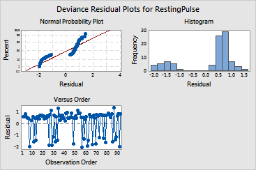

Graph window output

Plots: In the example, you chose three residual plots. The normal probability plot of the residuals is not a straight line, and the histogram of the residuals is bi-modal. You should be cautious about how you interpret output that relies on normal theory, like confidence intervals for the predicted probabilities.
