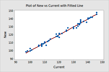

Graph window output
Interpreting the results
0 is contained in the confidence interval for the intercept (-2.77513, 4.06395) and 1 is contained in the confidence interval for the slope (0.96769, 1.02315). Therefore, no evidence exists that the two instruments measure different things.
