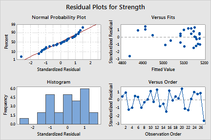

Graph window output

Graph window output
The histogram shows one potential outlier in the data.
The normal probably plot shows an approximately linear pattern consistent with a normal distribution.
The plot of residual versus the fitted values shows a random pattern, which suggests that the residuals have constant variance. See [11] for information on non-constant variance. This plot also shows one potential outlier.
The residuals versus order plot shows the order that the data was collected and can be used to find non-random error, especially of time-related effects. The residuals versus order plot does not display a pattern.
