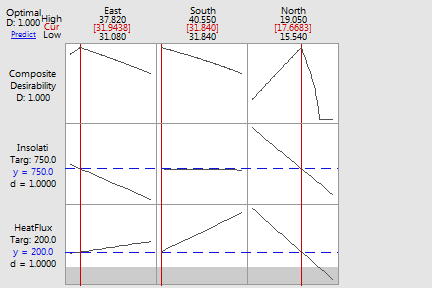

Interpreting the results
The combined or composite desirability of these two responses is 1, which indicates an excellent solution.
To obtain this desirability, you would set the factor levels at the values shown under Multiple Response Prediction. That is, East would be set at 31.9438, South at 31.84, and North at 17.6683. The predicted responses for these settings are 750.0 for Insolation and 200.00 for HeatFlux. The confidence intervals and prediction intervals indicate the precision of these predictions.
If you want to adjust the factor settings of this initial solution, you can use the plot. Move the vertical bars to change the factor settings and see how the individual desirability (d) of the responses and the composite desirability change.
The response optimizer uses model equations. Ensure that your models are adequate before you interpret the results.
