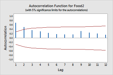

Autocorrelation for Food2
Graph window output
Interpreting the results
In the Session window, Minitab displays the autocorrelations, associated t-statistics, and Ljung-Box Q statistics. Because you did not specify the lag length, autocorrelation uses the default length of n / 4 for a series with less than or equal to 240 observations. Minitab generates an autocorrelation function (ACF) with approximate a = 0.05 critical bands for the hypothesis that the correlations are equal to zero.
The ACF for these data shows large positive, significant spikes at lags 1 and 2 with subsequent positive autocorrelations that do not die off quickly. This pattern is typical of an autoregressive process.
