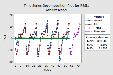

·    A time series plot that shows the original series with the fitted trend line, predicted values, and forecasts.

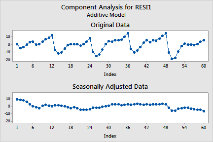

·    A component analysis - in separate plots are the series, the detrended data, the seasonally adjusted data, the seasonally adjusted and detrended data (the residuals).

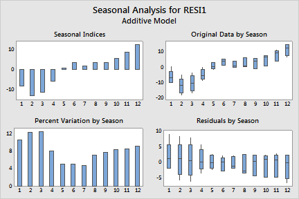

·    A seasonal analysis - charts of seasonal indices and percent variation within each season relative to the sum of variation by season and boxplots of the data and of the residuals by seasonal period.

In the example, the first graph shows that the detrended residuals from trend analysis are fit fairly well by decomposition, except that part of the first annual cycle is underpredicted and the last annual cycle is overpredicted. This is also evident in the lower right plot of the second graph; the residuals are highest in the beginning of the series and lowest at the end.
