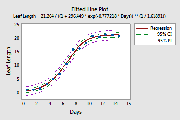

For example, researchers study the growth rate of leaves. They measure leaf lengths at different points in time. Based on their research, they decide to use the Richards growth model, a sigmoidal function that is often used in botany. Among other output, the Nonlinear Regression command produces this fitted line plot that displays the relationship and  regression equation.
