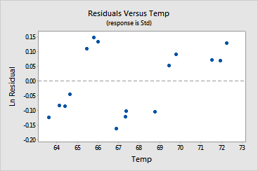

This graph plots the log residuals versus another variable. The residuals should fluctuate in a random pattern around the center line. If the variable is already included in the model, use the plot to determine if you should add a higher-order term of the variable. If the variable is not already included in the model, use the plot to determine if the variable is influencing the response in a systematic way.
Use this plot to look for the following:
This pattern...
Indicates...
Pattern in residuals
The variable is influencing the response in a systematic way
Curvature in the points
A higher-order term of the variable should be included in the model
Example Output
Interpretation
For the insulation data, the residuals appear to be randomly scattered about zero. No evidence exists that there is a pattern in the residuals or curvature in the data. The plot indicates that the temperature of the facility does not seem to have a systematic effect on the response.
