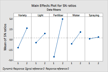

For the basil data, the main effects plot for the signal-to-noise ratio is shown. The plots indicate the following:
·    Fertilizer has the greatest effect on signal-to-noise ratio. Runs with Fertilizer 2 had much higher signal-to-noise ratios than runs with Fertilizer 1.
·    Spraying had virtually no effect on signal-to-noise ratio, which is shown by the almost flat line.
