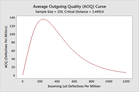

Graphs - Average Outgoing Quality (AOQ) Curve
This plot allows you to see the average outgoing quality level at various incoming quality levels.
Example Output
Interpretation
For the camera lenses, when the average incoming quality level is 100 defectives per million, the average outgoing quality appears close to 90 defectives per million. When the average incoming quality level is 600 defectives per million, the average outgoing quality appears close to 57defectives per million.
The worst outgoing quality level, the average outgoing quality limit (AOQL), appears to be when the incoming quality level of the lenses is approximately just over 200 defectives per million.
