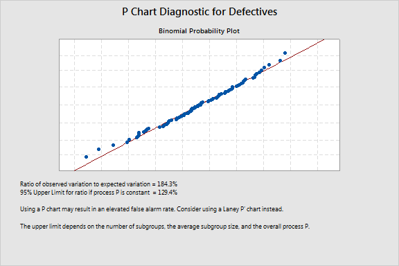

The results of the P Chart Diagnostic include the following elements:
·    Probability plot, which shows how well your data fit a binomial distribution.
·    Ratio of observed variation to expected variation expressed as a percentage, which you interpret as follows:
-    If the ratio is greater than the 95% upper limit, your data exhibit significant overdispersion.
-    If the ratio is less than 60%, your data exhibit significant underdispersion.
If your data exhibit overdispersion or underdispersion, a Laney P' chart may more accurately distinguish between common cause variation and special cause variation than a traditional P chart.
Example Output
Interpretation
The high ratio of observed variation to expected variation, 184.3%, suggests overdispersion. The ratio is greater than the 95% upper limit, 129.4%. Overdispersion can cause points on a traditional P chart to appear to be out of control when they are not. To correct for overdispersion, use a Laney P' chart.
