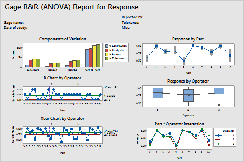

Graphs - Six-in-One
The six-in-one graph displays six gage R&R graphs in one graph window. The graphs include:
·    Components of variation - displays the sources of variation
·    R chart - indicates if operators are measuring consistently
·    Xbar chart - indicates if the measurement system is adequate
·    By Part - shows all of the measurements taken in the study, arranged by part
·    By Operator - shows all of the measurements taken in the study, arranged by operator
·    Operator*Part interaction - shows the average measurements taken by each operator on each part in the study, arranged by part
Example Output
Interpretation
To view the interpretation of each graph in the six-in-one plot, refer to the individual topic for each graph preceding this topic.
