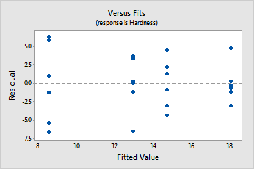

This graph plots the residuals versus the fitted values. The residuals should be scattered randomly about zero. Use this plot to look for the following:
This pattern... |
Indicates... |
Fanning or uneven spreading of residuals across fitted values |
Curvilinear |
A missing higher-order term |
A point far away from zero |
An outlier |
Example Output |
Interpretation |
Based on this plot, the residuals appear to be randomly scattered about zero. No evidence of nonconstant variance, missing terms, or outliers exists.
