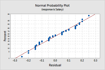

Example Output
Interpretation
For the salary data, the residuals appear to follow a straight line. No evidence of nonnormality, skewness, outliers, or unidentified variables exists.
