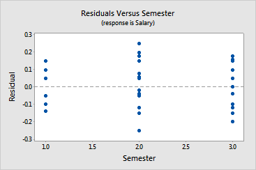

Example Output
Interpretation
For the salary data, the residuals appear to be randomly scattered about zero. No evidence exists that there is a pattern in the residuals or curvature in the data. The plot indicates that semester does not have a systematic effect on the response.
