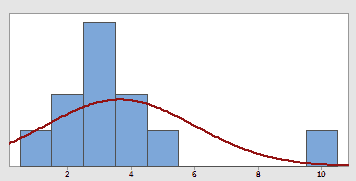

Histogram of Data with Normal Curve
You can use the histogram of the data overlaid with a normal curve to assess the normality of your data. A normal distribution is symmetric and bell-shaped, as indicated by the curve. (Note that the curve is truncated where it extends beyond the borders of the graph.) It is often difficult to evaluate normality with small samples.
Example Output
Interpretation
The precipitation data do not follow the normal curve. This is largely due to the outlier at the far right of the graph. Without this outlier, the data look much more normal, as illustrated below:
