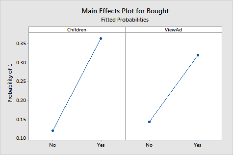

The main effects plot is most useful when you have several categorical variables. You can then compare the changes in the level event probabilities to see which categorical variable influences the response the most. A main effect is present when the event probability of the response changes at the different levels of the variable. For a variable with two levels, the event probability is higher at one level of the variable than at another level. This difference is a main effect. Main effects are only interpretable if the interaction effects are not significant.
Minitab creates the main effects plot by plotting the fitted event probabilities for each variable in the model. Minitab can plot event probabilities from the data for variables that are not in the model. A line connects the points for each variable. Look at the line to determine whether or not a main effect is present for a variable.
·    When the line is horizontal (parallel to the x-axis), then there is no main effect present. Each level of the variable affects the response in the same way, and the response event probability is the same across all levels.
·    When the line is not horizontal (parallel to the x-axis), then there is a main effect present. Different levels of the categorical variable affect the response differently. The greater the difference in the vertical position of the plotted points (the more the line is not parallel to the X-axis), the greater the magnitude of the main effect. To determine if a difference is statistically significant, check the p-value of the term in the analysis of deviance table.
By comparing the slopes of the lines, you can compare the relative magnitude of the effects.
Factorial plots do not use the data in the worksheet for the fitted event probabilities. Instead, Minitab estimates the fitted event probabilities based on a stored model. You must fit a model before you can generate a factorial plot. To produce an interaction plot, you must include two or more variables in the plots. Factorial plots are accurate only if the model represents the true relationships.
Example Output
Interpretation
For the cereal data, the plots indicate the following:
·    Children: Customers with children are more likely to buy the cereal.
·    ViewAd: Customers who saw the advertisement are more likely to buy the cereal.
The magnitude of the main effect for Children appears to be larger than the magnitude for ViewAd.  The main effects are only interpretable if the interaction effects are not significant.
