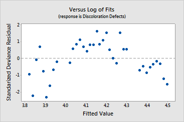

Deviance Residuals versus Fits
This graph plots the residuals versus the fitted values. The residuals should be scattered randomly about zero. Use this plot to look for the following:
This pattern...
Indicates...
Fanning or uneven spreading of residuals across fitted values
Nonconstant variance
Curvilinear
A missing higher-order term
A point far away from zero
An outlier
A point far away from the other points in the x-direction
An influential point
Example Output
Interpretation
For the resin defect data, there is a clear curve in the data. This pattern reveals a problem with the model. In this case, the analysts find that interactions that are in the data are not in the model.
