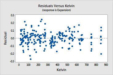

Graphs - Residuals versus the Variables
This graph plots the residuals versus another variable. The residuals should fluctuate in a random pattern around the center line. If the variable is already included in the model, use the plot to determine if you should modify the expectation function. If the variable is not already included in the model, use the plot to determine if the variable is influencing the response in a systematic way. If so, consider adding this variable into the model.
Use this plot to look for the following:
This pattern...
Indicates...
Pattern in residuals
The variable is influencing the response in a systematic way
Curvature in the points or other systematic difference from zero
An incorrectly specified expectation function
Example Output
Interpretation
For the copper expansion data, the predictor Kelvin is plotted versus the residuals. The residuals appear to be scattered randomly about zero which suggests the model accurately includes Kelvin.
