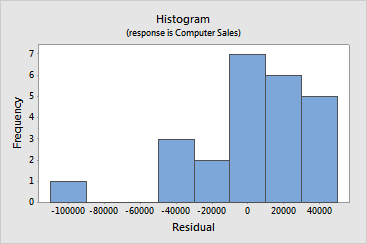

Graphs - Histogram of the Residuals
A histogram of the residuals shows the distribution of the residuals for all observations. Use the histogram as an exploratory tool to learn about the following characteristics of the data:
·    Typical values, spread or variation, and shape
·    Unusual values in the data
The histogram of the residuals should be bell-shaped. Use this plot to look for the following:
This pattern...
Indicates...
Long tails
Skewness
A bar far away from the other bars
An outlier
Because the appearance of the histogram can change depending on the number of intervals used to group the data, use the normal probability plot and goodness-of-fit tests to assess whether the residuals are normal.
Example Output
Interpretation
For the sales data, the bar on the left side of the plot indicates that an outlier may exist.
