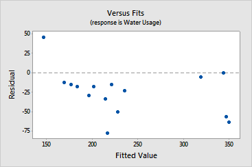

This graph plots the residuals versus the fitted values. The residuals should be scattered randomly about zero. Use this plot to look for the following:
This pattern...
Indicates...
Fanning or uneven spreading of residuals across fitted values
Nonconstant variance
Curvilinear
A missing higher-order term
A point far away from zero
An outlier
Example Output
Interpretation
Based on this plot, the residuals do not appear to be randomly scattered about zero. Evidence of nonconstant variance exists.
