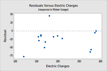

This graph plots the residuals versus another variable. The residuals should fluctuate in a random pattern around the center line. If the variable is already included in the model, use the plot to determine if you should add a higher-order term of the variable. If the variable is not already included in the model, use the plot to determine if the variable is influencing the response in a systematic way.
Use this plot to look for the following:

Pattern in residuals
The variable is influencing the response in a systematic way
Curvature in the points
A higher-order term of the variable should be included in the model

For the water usage data, the residuals do not appear to be randomly scattered about zero. Evidence exists that there is a pattern in the residuals. The plot indicates that the electric charges may have a systematic effect on water usage.
