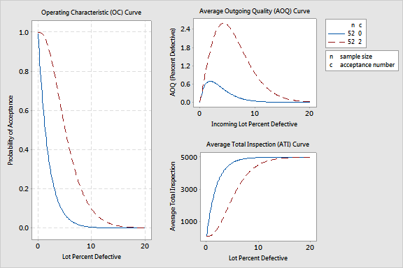

Suppose a vendor supplies pens with your company logo that you give away at trade shows. You receive the pens in lots of 5000 and have just implemented a sampling plan to inspect 52 pens. If the number of defectives is 2 or less, you accept the entire shipment. Assume the AQL is 1.5% and the RQL is 10%.
Your manager has objected to this plan and thinks that you should send the pens back if any defectives are found. You compare the current plan to his proposed one to highlight the risks and benefits of each plan.

Graph window output
Graphs - Acceptance Sampling by Attributes
Interpreting the results
When the acceptance number is at zero (like a zero-defectives program), the probability of accepting a lot at the AQL is too low to be practical in a sampling plan. In this case, the AQL is 1.5%, there is only a 0.456 probability of accepting lots at this defective level. When the sampling plan was set up, the consumer and supplier agreed that lots of 1.5% defective would be accepted approximately 95% of the time.
