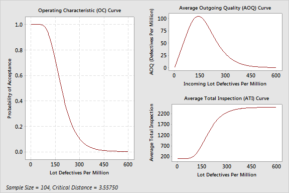

Interpreting the results
For each lot of 2500 pipe segments, you need to randomly select and inspect 104 of them. From the measurements of your random sample, determine the mean and the standard deviation to calculate the Z value. Z = (mean - lower spec)/ standard deviation. If a historical standard deviation is known, use that.
If Z.LSL is greater than the critical distance, in this case k = 3.55750, accept the entire lot; otherwise reject it.
In this case, the probability of acceptance at the AQL (100 defectives per million) is 0.95 and the probability of rejecting is 0.05. When the sampling plan was set up, the consumer and supplier agreed that lots of 100 defectives per million would be accepted approximately 95% of the time to protect the producer. The probability of accepting at the RQL (300 defectives per million) is 0.10 and the probability of rejecting is 0.90. The consumer and supplier agreed that lots of 300 defectives per million would be rejected most of the time to protect the consumer.
Acceptance sampling processes usually require corrective action when lots are rejected. When the corrective action is to perform 100% inspection and rework the defective items, the Average Outgoing Quality (AOQ) represents the average quality of the lot and the Average Total Inspection (ATI) represents the average number of inspected items after additional screening.
The Average Outgoing Quality (AOQ) level is 91.1defectives per million at the AQL and 28.6 defectives per million at the RQL. This is because when lots are very good or very bad the outgoing quality will be good because of the rework and reinspection for poor lots. The Average outgoing quality limit (AOQL) represents the worse case outgoing quality level.
The Average Total Inspection (ATI) per lot represents the average number of pipes inspected at a particular quality level and probability of acceptance. For the quality level of 100 defectives per million, the average total number of pipes inspected per lot is 223.2. For the quality level of 300 defectives per million, the average total number of pipes inspected per lot is 2261.4.
