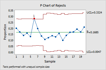

Suppose you work in a plant that manufactures picture tubes for televisions. For each lot, you pull some of the tubes and do a visual inspection. If a tube has scratches on the inside, you reject it. If a lot has too many rejects, you do a 100% inspection on that lot. A P chart can define when you need to inspect the whole lot.
1    Open the worksheet EXH_QC.MTW.
2    Choose Stat > Control Charts >Attributes Charts > P.
3    In Variables, enter Rejects.
4    In Subgroup sizes, enter Sampled. Click OK.
Session window output
P Chart of Rejects
Test Results for P Chart of Rejects
TEST 1. One point more than 3.00 standard deviations from center line.
Test Failed at points:  6
* WARNING * If graph is updated with new data, the results above may no
          * longer be correct.
Graph window output
Interpreting the results
Sample 6 is outside the upper control limit. Consider inspecting the lot.
