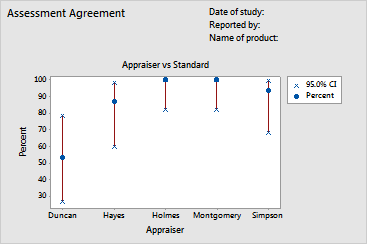

Graph window output

The Appraiser vs Standard graph provides a graphical display of the Each Appraiser vs Standard assessment agreement table. You can easily compare the assessment agreements for the five appraisers.
Based on this data, you conclude that Duncan, Hayes, and Simpson need additional training.
