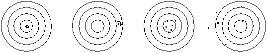

Measurement system errors can be classified into two categories: accuracy and precision.
·    Accuracy describes the difference between the measurement and the part's actual value.
·    Precision describes the variation you see when you measure the same part repeatedly with the same device.
Within any measurement system, you can have one or both of these problems. For example, you can have a device that measures parts precisely (little variation in the measurements) but not accurately. You can also have a device that is accurate (the average of the measurements is very close to the accurate value), but not precise, that is, the measurements have large variance. You can also have a device that is neither accurate nor precise.
accurate and precise
precise but not accurate
accurate but not precise
not accurate or precise
