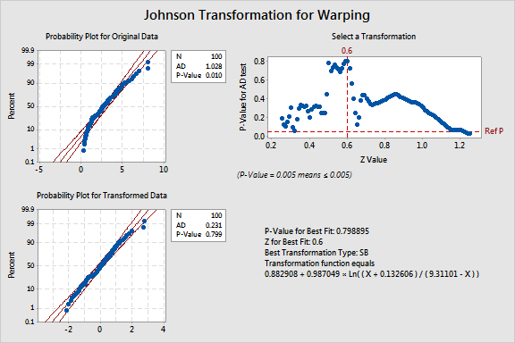

Graph window output
Interpreting the results
·    The normal probability plot allows you to compare the transformed data to the original data. The normal probability plot for the:
original data indicates that the data do not follow a normal distribution (AD = 1.028, P = 0.01).
transformed data indicates that the data follow a normal distribution (AD = 0.2310, P = 0.799).
·    The scatterplot of P versus Z over the range of 0.25 to 1.25 shows that the best transformation function is selected at Z = 0.6.
·    The table shows parameter estimates for the selected transformation function and their corresponding p-values and Z-values.
