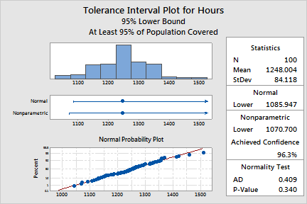

Graph window output
Interpreting the results
The manufacturer is interested in the minimum burn time that most light bulbs will exceed. Minitab calculates tolerance intervals using both the normal and nonparametric methods. If you can reasonably assume that your data are normally distributed, use the normal method results. Otherwise, use the nonparametric results. See Normal and nonparametric methods for tolerance intervals for more details.
The normal probability plot shows an approximately linear pattern that is consistent with a normal distribution. Additionally, the Anderson-Darling test's p-value (0.340) is greater than any reasonable a level. Thus, there is not enough evidence to suggest that the data do not follow a normal distribution. Use the normal method results.
In the graph, the Normal lower bound (1085.947) appears in the box on the right. The statistics table also displays the sample size and point estimates of the mean burn time (1248.004 hours) and the standard deviation (84.118) for the entire light bulb population.
The manufacturer is 95% confident that at least 95% of all light bulbs produced will exceed 1085.947 hours of burn time.
