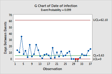

A hospital wants to monitor the number of post-surgical infections to ensure that the rate of infection remains low over time. Hospital staff record the date of each post-surgical infection. Because this data is rare event data, the staff use a G chart to track the rate of infections.

Session window output
G Chart of Date of infection
Test Results for G Chart of Date of infection
Benneyan Test. 3 points in a row equal to 0.
Test Failed at points:  30, 31
* WARNING * If graph is updated with new data, the results above may no
          * longer be correct.
Graph window output
Interpreting the results
Observations 30 and 31 failed the Benneyan test because 3 points in a row are equal to 0. The staff recorded 3 or more infections on the same day. The data analyst examines the worksheet and observes that hospital staff recorded five infections on October 26.
