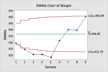

In the following example, Weight contains the weight in pounds of each batch of raw material.
1    Open the worksheet EXH_QC.MTW.
2    Choose Stat > Control Charts >Time-weighted Charts >  EWMA.
3    Choose All observations for a chart are in one column, then enter Weight.
4    In Subgroup sizes, enter 5. Click OK.

EWMA Chart of Weight
Test Results for EWMA Chart of Weight
TEST 1. One point more than 3.00 standard deviations from center line.
Test Failed at points:  2, 3, 4, 5

Graph window output
Interpreting the results
The EWMAs for sample numbers 2, 3, 4, and 5 fall more than 3 standard deviations below the center line, suggesting small shifts away from the target.
