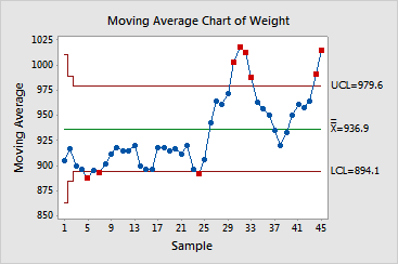

Moving Average Chart of Weight
Test Results for Moving Average Chart of Weight
TEST 1. One point more than 3.00 standard deviations from center line.
Test Failed at points:  5, 7, 24, 30, 31, 32, 33, 44, 45
* WARNING * If graph is updated with new data, the results above may no
          * longer be correct.
Graph window output
Interpreting the results
The moving average chart shows nine points that are more than 3 standard deviations away from the center line. You should closely examine the quarry's processes to improve control over the weight of the limestone shipments.
