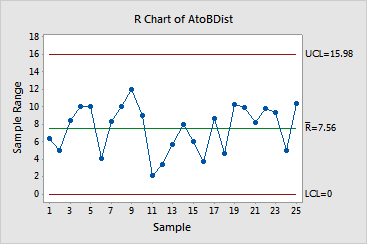

You have already displayed an X chart with the data to track the process level and test for special causes. Now you want to display an R chart to track the process variation using the same data.
1    Open the worksheet CRANKSH.MTW.
2    Choose Stat > Control Charts >Variables Charts for Subgroups >  R.
3    Choose All observations for a chart are in one column, then enter AtoBDist.
4    In Subgroup sizes, enter 5.
5    Click R Options, then click the Tests tab.
6    Choose Perform all tests for special causes. Click OK in each dialog box.
Graph window output
Interpreting the results
The points are randomly distributed between the control limits, implying a stable process. It is also important to compare points on the R chart with those on the X chart for the same data - see Example of an X chart with tests and customized control limits to see if the points follow each other. These do not - again, implying a stable process.
