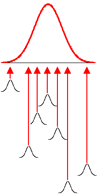

For example, you inspect equipment at a candy factory, including a machine that fills containers with a certain weight of candy. Candy shipments leave the factory once each week. To assess the capability of this process, you weigh a sample of bags each day for a week; each sample represents a subgroup in your analysis. You observe that the variation within each subgroup is small, but because the subgroup means shift from day to day, the overall variation of weight of all bags is much greater. Consequently, the entire weekly shipment has larger variation in bag weight than the bags produced on any given day. In the chart below, the small distributions represent the distribution of bag weight for each of seven consecutive days. The topmost distribution represents the entire week's shipment, which is an aggregate of the subgroups.
Overall capability considers the topmost curve: what the customer feels. It is also called actual capability or long-term capability.
Potential capability considers the variation within subgroups: how well could your process perform if you eliminated variation between subgroups. It is also called short-term capability.
